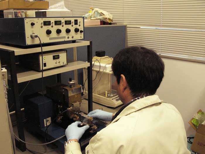

To determine ways to reduce bearing vibration, noise, and friction torque, Sugawara develops Anderon meter (Innovative Tribomaterials Group at the National Institute for Materials Science)
The Innovative Tribomaterials Group pursues research on new tribomaterial coatings for ball bearings designed for use in extreme environments, including high temperatures and vacuums. Sugawara Anderon Meters and pusher torque sensors are designed to evaluate ball bearing performance and to determine how to reduce bearing vibration, noise, and friction torque using solid lubricant coatings in place of lubrication oil.
