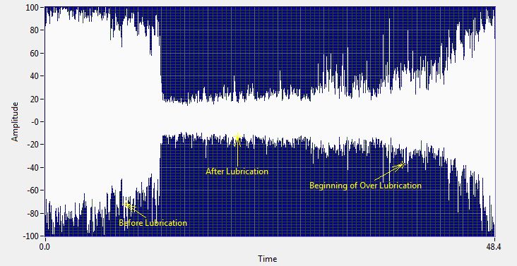

Bearing Lube Example I: This is a Time Wave Form of a recorded ultrasound of a bearing in the process of being lubed. The approximately 1 minute sound file shows the bearing before and after lubrication.

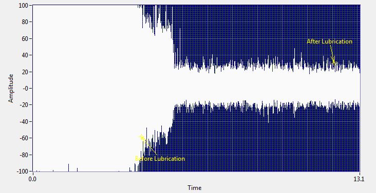

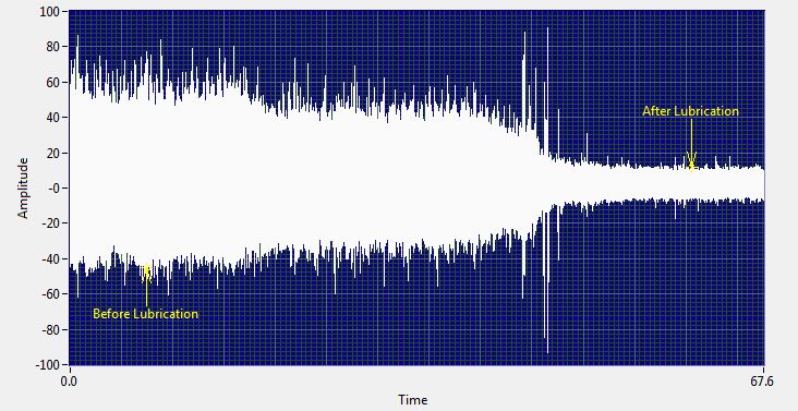

Bearing Lube Example II: Another Time Wave Form of a bearing in the process of being lubed over 13 seconds. Again, a distinct before and after lube can be seen.
Bearing Beginning of Over Lube: This recording shows the bearing dB & amplitude increase as more lube is added and has reached the threshold of over lubrication.

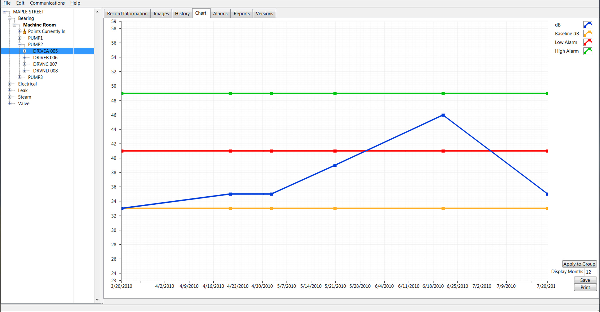

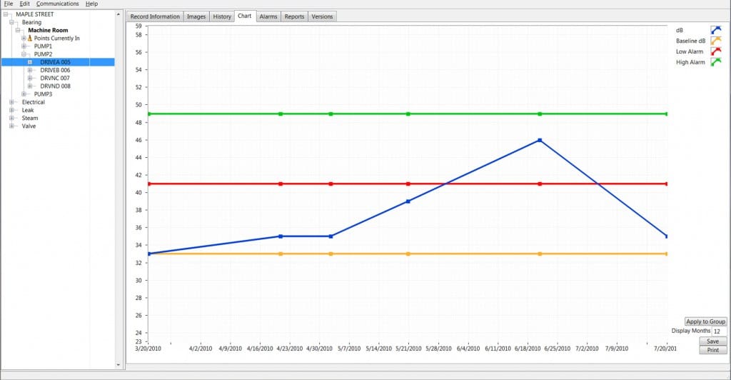

Drive Bearing Lube history: This chart shows a trend of decibel readings taken on a drive bearing. The readings are plotted against a baseline dB, a low alarm dB, and a more critical high alarm dB.

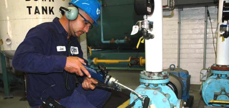

Ultrasonic technology helps the lubrication technician take a lot of the guesswork out of lubrication needs. Ultrasound is a localized signal meaning when a sensing probe is applied to a bearing, it will not be affected by “crosstalk” and allows the technician to hear and monitor the condition of each individual bearing. Ultrasound looks at each individually, much the same way medical ultrasound can detect exactly which artery is clogged or which vein is leaking.

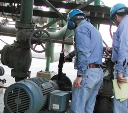

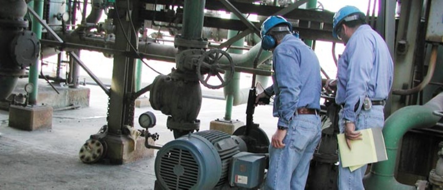

The first step is establishing both a baseline decibel level and a sound sample. This is ideally done when moving through a route for the first time by first comparing dB levels and sound qualities of similar bearings. Anomalies will be easily identified. Once established, each bearing can be trended over time for any changes in either amplitude or sound quality.
Generally speaking, when the amplitude of a bearing exceeds 8 dB and there is no difference in the sound quality established at baseline, the bearing needs to be lubricated. To prevent potentially disastrous over-lubrication, the technician will then apply lubrication, a little at a time, until the dB level drops. Many departments set up their “Condition-Based” lubrication programs by incorporating a two- stage approach. The reliability inspector uses a relatively sophisticated ultrasound instrument to monitor and trend bearings. A report of bearings in need of lubrication is produced. The lube tech then uses a specialized ultrasound instrument that alerts the tech when to stop adding grease. (These instruments can be affixed to a regular grease gun or worn in a holster.)
