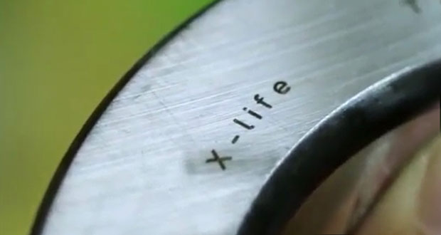

Schaeffler has extended its premium quality X-life product family with a new range of high performance track rollers that offers a significantly higher load carrying capacity and a longer rating life than its predecessors.

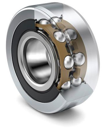

The redesigned LR52 and LR53 series of track rollers are the latest additions to Schaeffler’s X-life product family. With an increased dynamic load rating of 15% compared to competitors’ products, combined with a speed limit increase, the LR52 and LR53 X-life track rollers are the highest performing track rollers currently available on the market.
Both series are available exclusively in premium quality X-life standard. As the external dimensions remain the same as their predecessors, the LR52 and LR53 X-life track rollers are direct replacements for existing track rollers, with no modifications required to the customer’s application.
Upgrading the track rollers to X-life quality required improvements to the internal design of the bearing. The LR52 and LR53 series incorporate a variety of new design features that result in an increased dynamic load rating of up to 10% and an increased static load rating of up to 15%. These improvements also result in significant increases in the bearing rating life.
Both series are offered with DEHP-free HRS seals as standard or with improved steel sealing shields (Z) as an option. Customers can also choose between an optimised polyamide cage or a rigid, robust steel cage.
What is a track roller?
Track rollers are self-retaining double-row units with particularly thick-walled outer rings. In addition to high radial forces, these bearings can also support axial forces in both directions. The outer rings have a crowned or cylindrical outside surface. Designs with a crowned outside surface are used where they are inclined in relation to the mating track, ensuring reducing edge loading if misalignment occurs.
