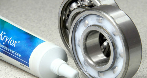

Krytox® AUT 2E45 grease has been field tested and proven as a ‘lubed-for-life’ solution for
 ball bearings in industrial electric motors at a pulp and paper production facility, as well as in other industries with similarly harsh service conditions. Photo: DuPont
Neu-Isenburg, Germany, March 2015 – Krytox® AUT 2E45 is a high performance grease from DuPont with proven lubed-for-life capability in industrial electric motor ball bearings. Unlike most conventional products, Krytox® greases do not oxidise, are water-resistant, nonflammable, and chemically inert. Krytox® AUT 2E45 offers excellent long-term lubrication for sealed ball-bearings in electric motors up to 200 horsepower (circa 150 KW). Based on perfluoropolyether (PFPE) oil and shear stable polytetrafluoroethylene (PTFE) thickener, Krytox® AUT 2E45 is compatible with commonly used motor materials including metals, winding & cable insulation, and shaft seals. Krytox® AUT 2E45 is pure white in colour and has a DIN standard classification of KFK2S-40.

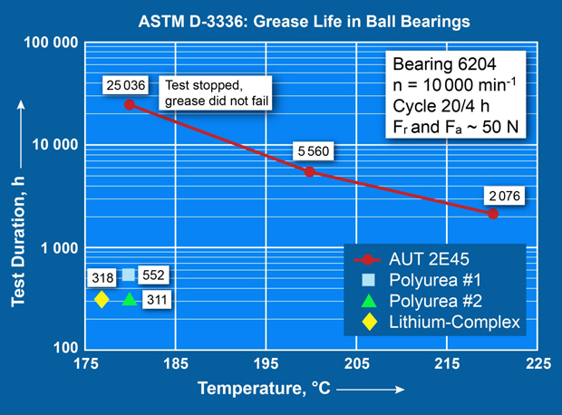

Comprehensive comparative testing was carried out between of Krytox® AUT 2E45 and industry standard motor greases. The results clearly demonstrated the superiority of Krytox® – lasting up to 64 times longer than ordinary greases in elevated temperature testing (see graph). On the basis of these results, Cariboo Pulp & Paper began fitting fully sealed bearings prefilled with Krytox® during their routine motor overhauls. Since the program started seven years ago, not one of these electric motors has failed due to problems with the bearings.
By keeping the solution simple, operational reliability is much improved and the company has been able to save the time and ongoing cost of a regular regreasing program.
Laboratory results from ‘ASTM D-3336: Standard Test Method for Life of Lubricating Greases in Ball Bearings at Elevated Temperatures’ clearly demonstrated the potential for a truly ‘lubed-for-life’ solution for industrial electric motor ball bearings. In the accelerated life test, Krytox® AUT 2E45 retains its excellent lubrication effect over the long term when compared to industry standard electric motor bearing greases.
 Graph: DuPont
