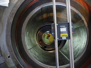

The first stage involved checking the alignment of the bearings to one another. This was done using CENTRALIGN measurement system. This devicemeasures the alignment of bores and bearings relative to one another to a high degree of accuracy.
First, the system’s laser was mounted on the upper generator bearing using a magnetic holder (Figure 3).
Assembly of the laser

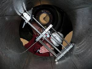

The counter piece to the laser is the sensor. Mounted on a pointed bracket, it was clamped in place using a special quick-assembly holder in the plain bearing being measured in a way that allowed it to be rotated. (Figure 4)
Assembly of the sensor
The measurement was made by sampling several measurement points on two measuring planes on each plain bearing. The laser merely acted as a reference line for the sensor. The sensor then transmitted the measurement data wireless to the control unit of CENTRALIGN  Ultra. The inclination of the individual plain bearings themselves was calculated in addition to their alignment to one another. The measurement system of ROTALIGN Ultra is capable of achieving measurements accurate to 1-2/100 mm per meter of the measured section.

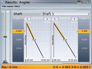

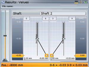

The final step deals with the measurement results (Figure 6)
ROTALIGN Ultra hydropower showed that the position of the shaft segments exhibited a difference of only 3/100 over a segment length of 4 metres (Figure 7a); a very low value. This proves that the bearings are now very well positioned. Examining the perpendicular gives an offset of 0.65 mm along the entire 8-metre length of the shaft downstream (Figure 7b) and to the west. If required, the perpendicular alignment of the shafting could be improved by adjusting it on the upper thrust bearing. However, according to the operator, this value does not affect the operation of the turbine; rather it is the alignment of the two shaft segments which has the most significance. The shafting itself and the bearing alignment are accurate and very well aligned to one another. The bearing damage on the lower generator and turbine bearing is now a thing of the past. With the new ROTALIGN Ultra Hydropower the user now has a high-precision, high-speed measurement system capable of determining the relative position of vertical shafts and ensuring they are perpendicular without using the line of sight.
