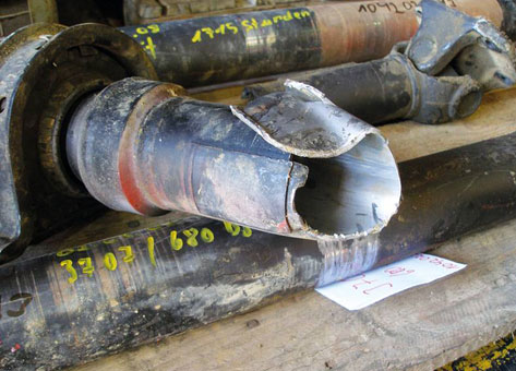

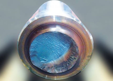

Forced fractures, for example, are often caused by malfunctions, seizures or overloads. Fatigue fractures and cracks can be caused by impermissible load vibrations or disturbing vibrations. Typical fatigue fractures or forced fractures in a universal joint shaft are shown in Figure 1.

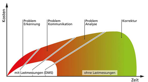

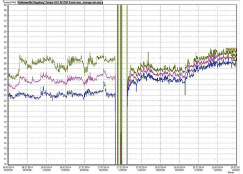

An additional load analysis can be applied to more quickly analyze and communicate the causes of atypical damage, as well as to reduce impermissible dynamic loads through knowledge, experience and/or increased precision. Reduced dynamic loads mean that machine components that are subject to complex loads during rolling, friction and impact processes will “run” better and “reward” the owner with a longer service life.
Figure 3 illustrates this for a large mill drive system before and after an optimization was implemented. The minimum, mean and maximum torque values are shown in kNm, each recorded at an interval of 5 minutes. Reduced load variations can be detected starting on 03/27.

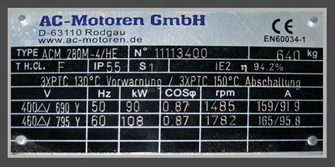

Drive technology is designed on the basis of information contractually agreed between the plant or machine manufacturer and the respective component manufacturer. In the case of existing machines, the first source of information concerning loads is the type plate, which contains values such as the rated speeds and rated outputs.
Some type plates also include information on torques and maximum permissible application torques. The application factors and safety factors actually used by the design engineer often can only be determined by researching in catalogs, drawings, safety documentation, operating manuals and even the contracts between the seller and buyer.

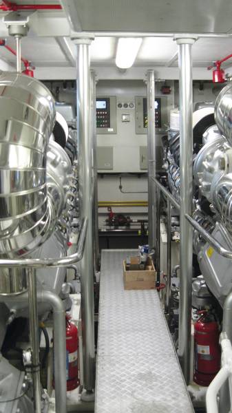

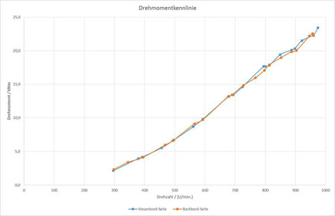

A 38-m charter yacht (Figure 6) was unable to reach its desired speed. Starting at a certain load level, secondary vibrations could be felt in the hull. It was suspected that cavitation was occurring and that the propellers were unsuitable for the hull.

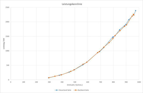

PRÜFTECHNIK was commissioned to conduct torque measurements to analyze the cause of the load vibrations and determine the propeller characteristics. For this purpose, strain gauges were applied on both the port side and starboard side propeller shafts; also, two telemetry systems were mounted and a mobile VIBXPERT was used to measure static and dynamic torques in recording mode. Figure 7 shows the analyzed propeller characteristics for the motor output and the torque for both sides. The following conclusions can be drawn:
Both motors operate at a similar load level. Both the port and starboard motors are evenly adjusted. There is no “turbo lag”.
Neither motor reaches its rated output, which confirms that the propellers are not suitable for the hull. The propeller characteristics make it possible to determine which alternative propellers would be effective. Whether the number of blades should also be changed is left to the discretion of the propeller manufacturer. Detailed analyses showed that the port side achieves a lower output.
Analyses of the dynamic torques showed that one blade of the 4-blade propeller on the port side was projecting. This caused additional load vibrations, which at maximum speed even resulted in initial signs of cavitation. The affected blade was the one just after the attached speed marker, which can easily be identified by the “propeller blade pattern” after removing the propeller.

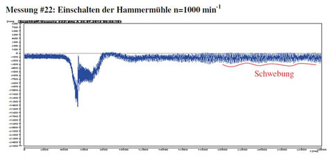

A manufacturer of a mobile grain mill wanted to know which static and dynamic loads existed in his vehicle under typical and atypical process conditions and where potentials for improvement might be found. For this purpose, strain gauges were applied at several measurement locations on the vehicle and the operating behavior was analyzed to determine any undesired load vibrations.
Figure 8 shows an example of a time signal of the torque when the hammer mill was switched on and views of two torque measuring locations.

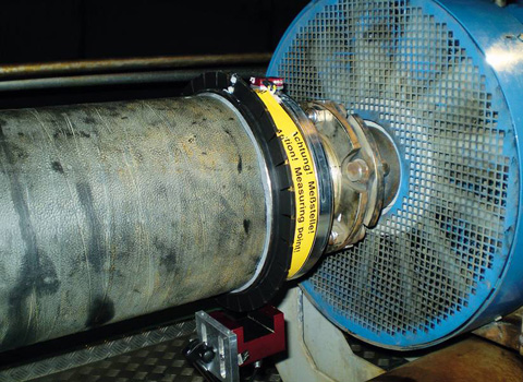

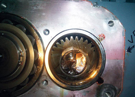

In a power plant drive system, inexplicable gear tooth damage occurred in a
gearbox. Based on systematic damage analyses, the occurrence of overloads
was suspected. Torque measurements were conducted to determine whether
the start-up or switching processes in the pole-changing motors were responsible.
Figure 9 shows a view of the measurement location near the gearbox. In the torque signals, three torsional natural frequencies can be identified. A soft starter was retrofitted to reduce the excessive amplitude of the first torsional natural frequency directly after start-up.

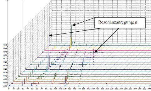

According to torsional vibration calculations, a variable speed pump unit was subject to resonance at certain speeds.
Are modifications necessary? How exact are the simulations for this new machine? Which amplitudes occur in the application? PRÜFTECHNIK was commissioned to conduct systematic torsional vibration analyses. Torque measurements at different RPMs made it possible to validate the calculated natural frequencies for the specific frequencies. Figure 10 shows an example of this type of Campbell diagram for torques up to 300 Hz. Based on this representation, it was possible to make the load amplitudes of the torsional vibrations available to the calculation engineer to enable him to further adjust the torsional vibration model. These results were also used to specifically hide the torsional vibrations at 48 Hz.
