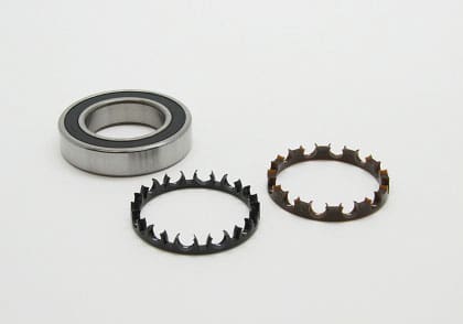

“Grease Lubrication Type High Speed Deep Groove Ball Bearing” for EV/HEV (left), newly developed retainer (center) and conventional retainer (right)

The newly developed “Grease Lubrication Type High Speed Deep Groove Ball Bearing” for EV/HEV features a reviewed material ratio with the use of a new plastic retainer, while the retainer shape and material ratio have been modified to minimize its level of distortion due to centrifugal forces when operating at high rotational speeds. A smooth grease supply along the raceway surface also helps to increase sliding between the retainer and steel balls.

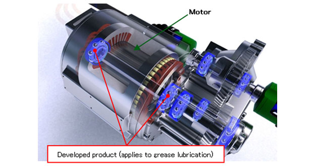

Applicable parts (example) of motor for EV
The filled grease has also been optimized with a combination of consistency (thickening agents) that can resist centrifugal forces at high rotational speeds, and viscosity (base oil) that can supply lubrication constituents to the raceway surface at high speeds, resolving the lack of lubrication when operating at high rotational speeds.
