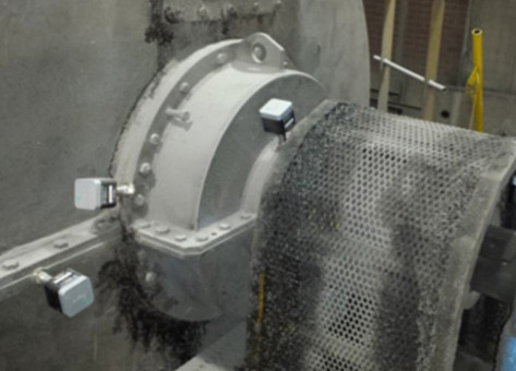

The plant is a cement industry producing close to full capacity, established for many years in Western Europe. The Equipment is a huge cement ball mill. The suspected mechanical assembly is the gearbox and its electrical drive 1MW. Customer requests I-Care support after a suspected increase in vibration level. In order to do a close monitoring and diagnostic of the vibration on the complete assembly, the analyst decide to install Wi-care wireless system.
Analyst diagnosis and spectrum justification: Gear frequency
Wi-care system is set on the gearbox and the electrical drive in a minute using magnet to cover classical vibration directions, vertical, horizontal and axial.
Note on the right side of the picture the Wi-care speed sensor directly measuring with a keyphasor on the shaft.
Standard spectrum collected via Wi-care in vertical direction. Display in speed units. The dominant frequency appear at 373,9 Hz and its harmonics.
On a closer zoom on 373,9 Hz appears modulation at 5Hz. The amplitude is close to 4 mm/sec RMS.
Looking in the drawings and data sheet, we can find the gearbox specifications and calculate theoretical fault frequencies
Calculate Gear mesh frequency of 373,71 Hz and its harmonics match the measured frequency of 373,9 Hz. Detected 5Hz modulation are linked to a ring defect (5.01 calculated). Amplitude trend indicate a 100% growth in a few days. Decision was taken by customer based on analyst recommendations via Wi-care measurement to start the maintenance process. Root cause of gear defect is an excessive looseness in the gear assembly due to structural cracks.
