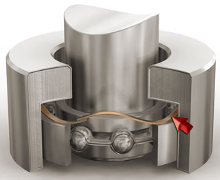

SSB Series (PDF) Bearing Preload Springs
Gap and Overlap type Wave Springs designed to match popular metric bearing sizes. Available in both carbon and stainless steel from 16 mm to 600 mm diameters.
Smalley Circular-Grain® bearing preload Wave Springs eliminate play and minimize bearing noise. The constant light/medium pressure they apply removes play between the ball bearings and the bearings’ inner and outer races. Preloading can reduce the possibility of bearing damage due to vibration (vibratory loading) and wear due to repetitive and non-repetitive runout.
