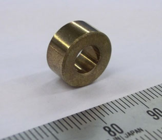

[ Product photo ]
NTN Bearphite1
Example of size: inner diameter 6mm × outer diameter 12mm × width 6mm
