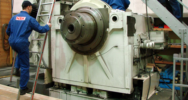

The principal problem in replacing the bearings related to the machine´s age and the fact that the original manufacturer had changed ownership. This meant there was no documentation relating to the main spindle assembly. For this reason, Doppelmayr turned to NSK, which was able to support the company in a reverse engineering project that would help identify the bearing locations and assembly parameters, including the bearing clearance and spacer ring width. NSK also helped develop strategies for replacing the bearings.
nsk-12042016-cnt4
Experts from NSK supporting Doppelmayer’s maintenance personnel with the replacement of the main spindle bearing.
By characterising the installed bearings through reverse engineering, NSK was able to replace them in the central bearing positions with high precision double row cylindrical roller bearings in the correct sizes. The replacement took place during a planned maintenance period so that production schedules were unaffected. For the axial bearings, spacer rings were measured after setting the clearance and new ones manufactured in the required width.

Post-installation, NSK technicians checked the clearance to make sure it was correct. This was facilitated by conducting a dynamic lift test, allowing the loading conditions to be simulated with the bearings installed. The process confirmed that the previously measured value of 0.005 mm had been successfully maintained.
nsk-12042016-cnt7
The bearings in installed state
With the project complete and the surface wheel lathe ready to recommence operations, Doppelmayer’s maintenance team was given instructions by NSK to monitor the temperature of the bearings during the initial start-up phase. No irregularities were observed and the lathe is now back in full sheave production.
