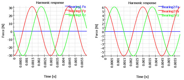

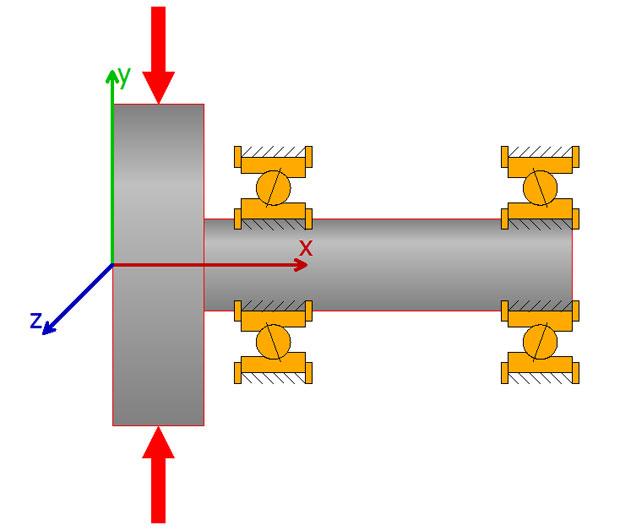

As an example a simple rotor is used. An imbalance of 5gmm is considered on the left side for a rotation speed of 20000rpm. This would lead to a dynamic force of . The calculated harmonic response at 20000rpm is 30.9N for the left bearing and just 6N for the left bearing. Note that the difference is larger than the calculated value of the dynamic force of 21.93, this is because of the dynamic forces of the shaft.

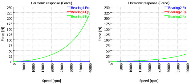

The harmonic response is speed dependent. The bearing forces will rise if the rotation speed approaches the natural frequency.

A diagram showing bearing forces over time for the given speed is available too, there the opposite direction of both forces can be seen:
mesys-18012016-cnt5+6
As the bearings have an isotropic stiffness matrix, the amplitudes in y/z-directions are the same. If the amplitudes would be different and larger than the static forces, the assumptions of the calculation would not be valid.

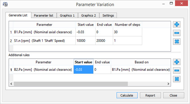

As input for the calculation, additional rules can be specified. The simple rotor from above is used again and the axial clearance for bearing 2 is set to the same value as the axial clearance of bearing 1.
Axial clearance of the bearings and the shaft speed are varied in a given range:

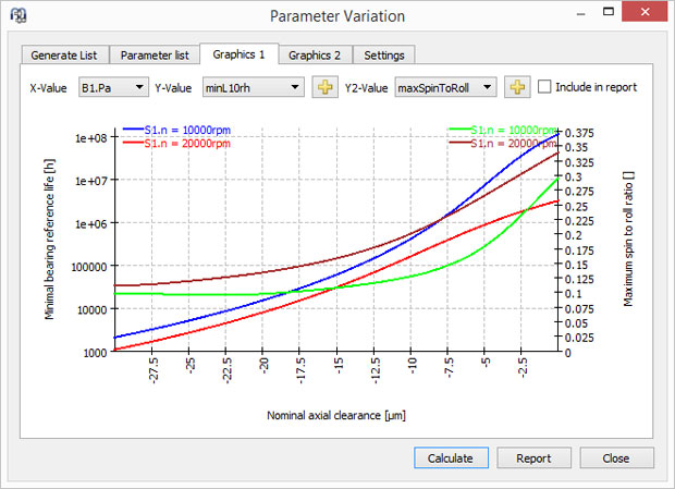

In the result graphics a second axis was added. So several results can be shown in the same diagram like the minimal bearing life and spin-to-roll ratio in the following image. Bearing life and spin-to-roll ratio are shown for two rotation speeds of the shaft.
